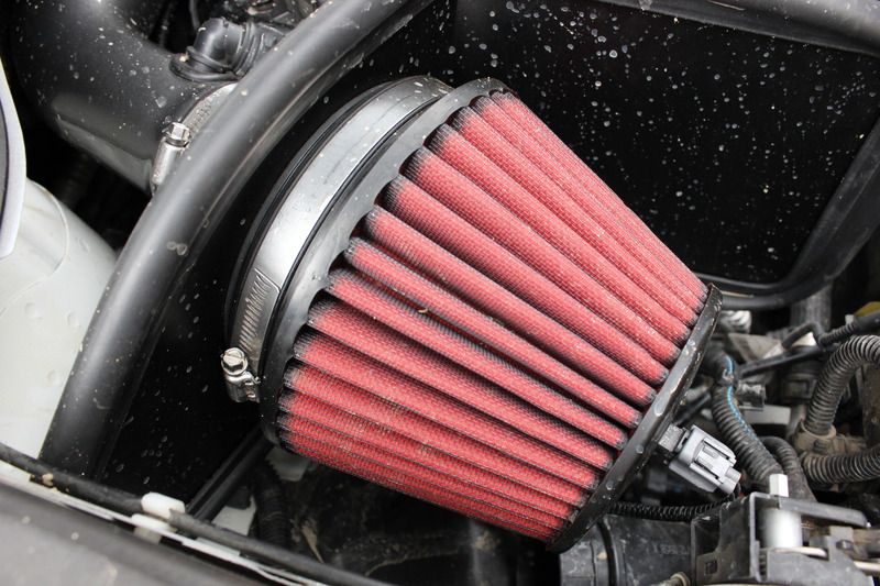

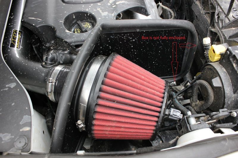

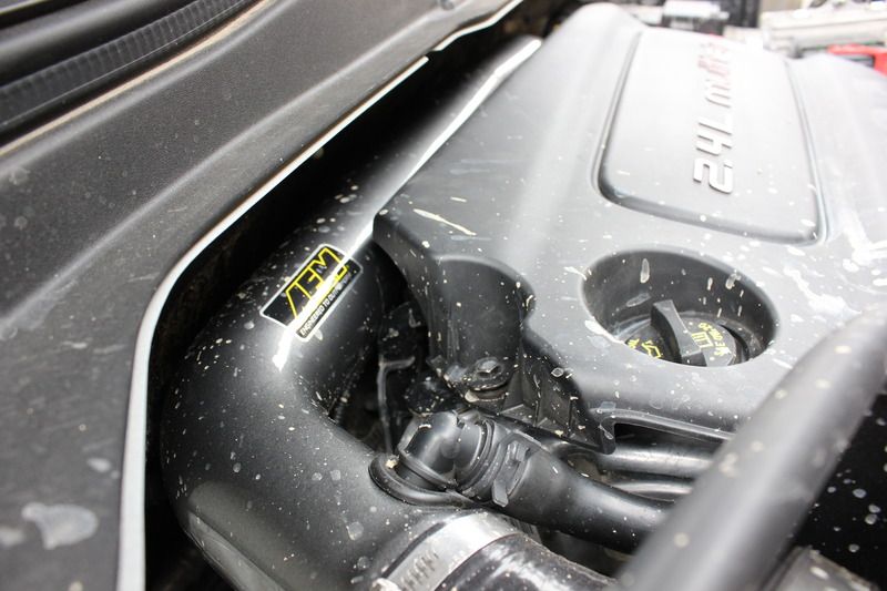

2015 Jeep Renegade Trailhawk 2.4L MultiAir Gasoline Eninge
AEM Intake System
(AEM is a part of K&N)
This is a full system. Meaning that it runs the full length of the OEM system and utilizes a pod filter rather than the filter box.
A drop in filter replaces the OEM paper filter in the filter box.
A short ram intake is shorter than the OEM system.
And a cold air intake is piped out of the engine by into the fender well or front bumper.

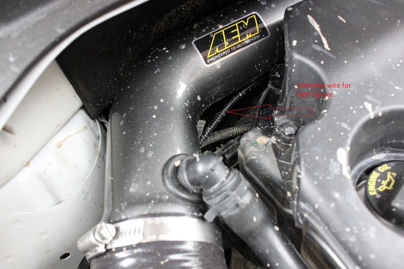

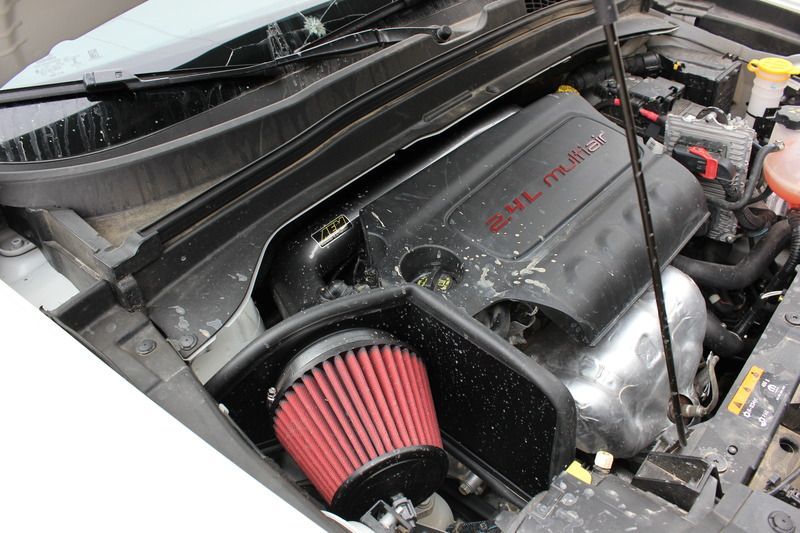

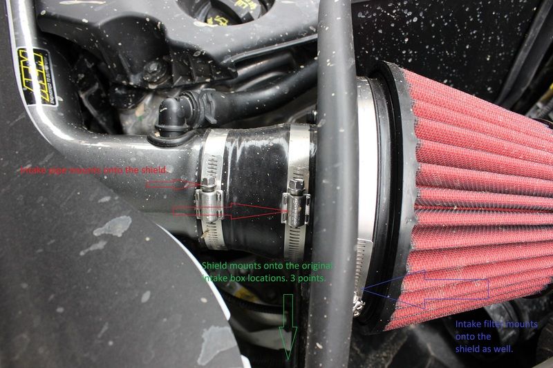

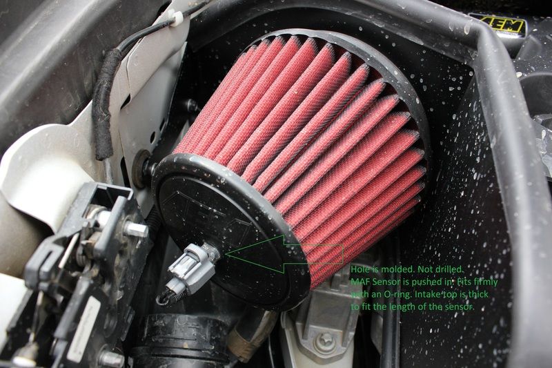

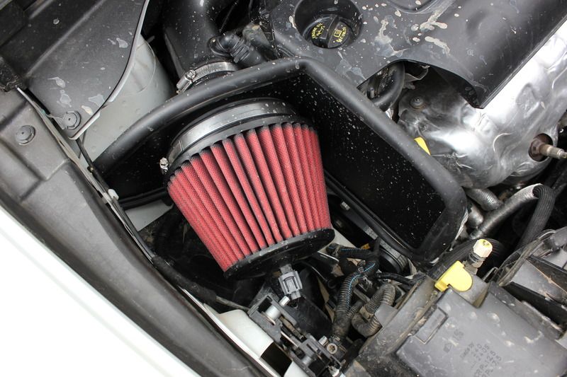

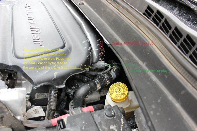

Installing an intake system is pretty straight forward. I received my Renegade back with the intake system already installed. So this is an overview of the system installed and details you might want to pay attention to when installing a similar system.

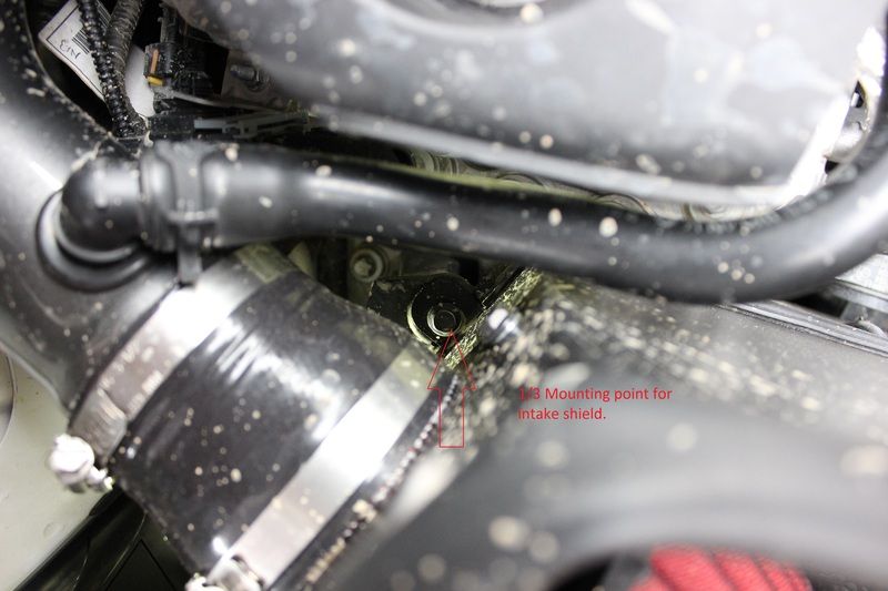

I've cross through a foot of water with the stock system and it can get messy under there. If your rolling through the water it should be fine. If you splash through it, you might be in trouble.
There are shields and socks out there that can help. I'm not too worried about it at the moment.

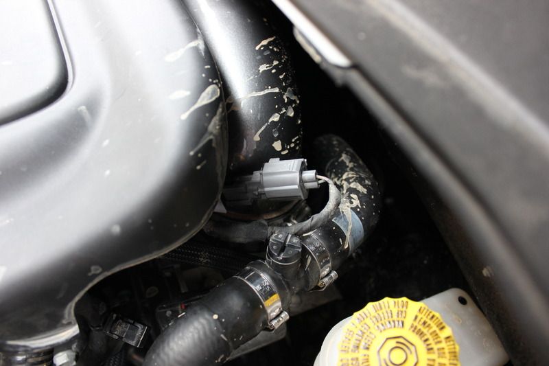

That is not the MAF sensor. That is the IAT. As fas as I can discern, there is no MAF sensor. The new IAT position is also useless. It more than likely is reading engine bay temps and not intake air temp. The factory system actually pulls in colder air. That setup is pulling in heated air. Most definitely not a CAI.
