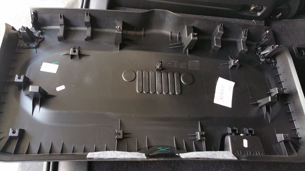

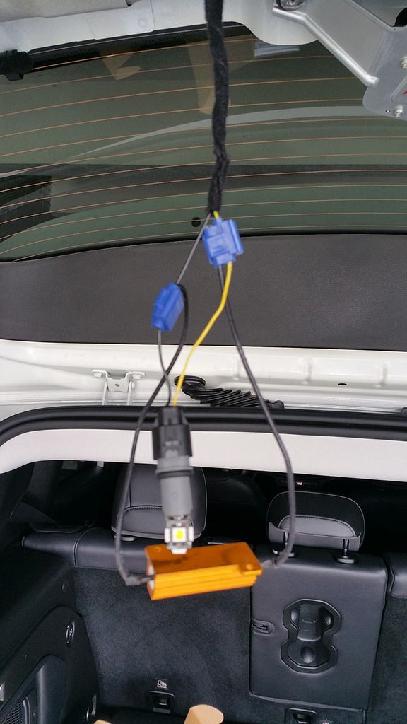

Hello. After searching this forum to find LED license plate bulbs that would not throw a error and not being successful I tried something I figured would work and did. Just buy normal non CAN BUS LED bulbs. I bought these:

Then buy these 25 watt resistors:

To hook them up you'll have to take off the back panel on the inside of the tail gate. Theres one screw in the handle then pry the back panel off. Be careful as the plastic bolt things can break easy and cost $7 a piece. It helps if you go to Harbor Freight or somewhere and buy a plastic trim panel remover kit. Then pry carefully at each location where there is a plastic clip.
Make sure you have the right resistors. They sent me the wrong ones at first and didnt notice it for awhile after I tried wiring them up and they didnt work. They will say 25W on the top. They have really good customer service so dont worry if theres a problem.
If you buy the ones from super bright throw away the blue quick splice connectors and get the smaller red ones. After using the blue ones the wire kept coming out and I needed to use a smaller one. Doesnt matter which wire from the resistor to the stock plate bulb socket wiring. Just one wire (resistor) per wire (socket). Then just use some double sided tape to mount the resistors and put the panel back on and you're done.
The bulb has to be non CAN BUS. I tried a CAN BUS bulb and I still got the warning. Non CAN BUS and it went away and its been fine for over a month.

Heres some pics wired up including the back cover off so you can see where to pry. The resistors pictured are the wrong ones as they sent me the wrong ones originally but I put the new ones on all the same way. The bulbs pictured are the CAN BUS. Again make sure they are non CAN BUS bulbs like the link I posted above.
