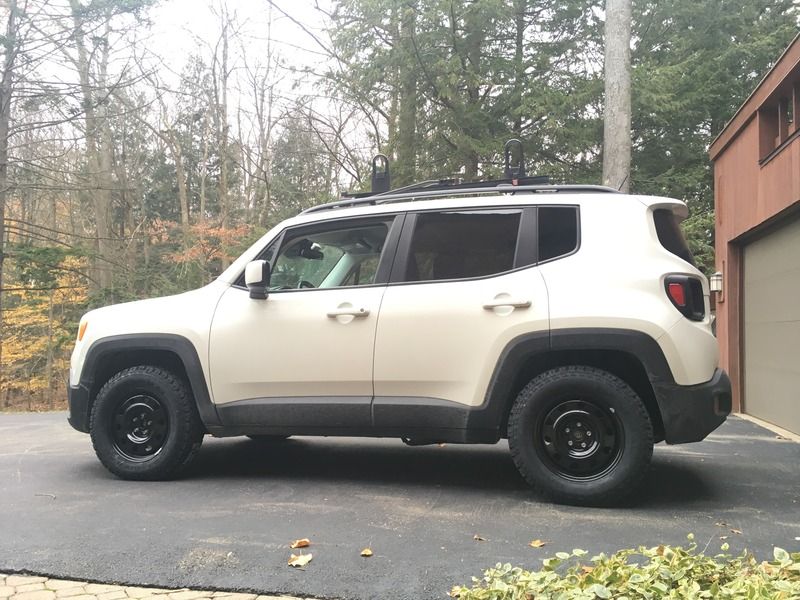

I have a trailhawk with Geolander MT at 225/75/16, No lift, with 20mm spacers in the front and rear. Without the spacers they just barely, and I mean barely touched the bottom of my front struts. Cleared the backs easily without spacers.
